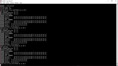

I have enrolled the gateway and the end node of my PNUCLEO lrwan 3 on Loriot server, but when I view the boot log on my Terra Term terminal, I observe that the end node does not join the server, returning JOINED FAILED.
I made sure the end node and the gateway are configured to the same frequency - EU433
I also made sure I used the correct details like the dev EUI, APP EUI amd AppKey from the end node to connect to the server, what could be the cause of this JOIN FAILED.

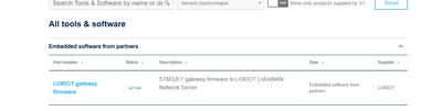

027iconic
Associate II
The gateway firmware for Loriot server is still marked active on the PNUCLEO LRWAN 3 page so, I guess it is still supported by LORIOT.
You should really confirm that with LORIOT...
