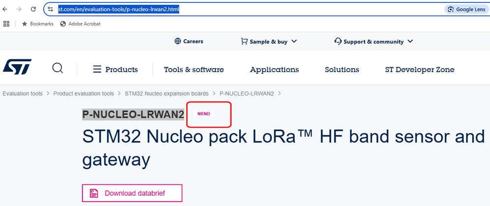

2025-04-15 6:17 AM
Do you mean P-NUCLEO-LRWAN2:
https://www.st.com/en/evaluation-tools/p-nucleo-lrwan2.html
If so, note that this is NRND (Not Recommended for New Designs):
Also note that it may not be suitable for deployment on a public network:
