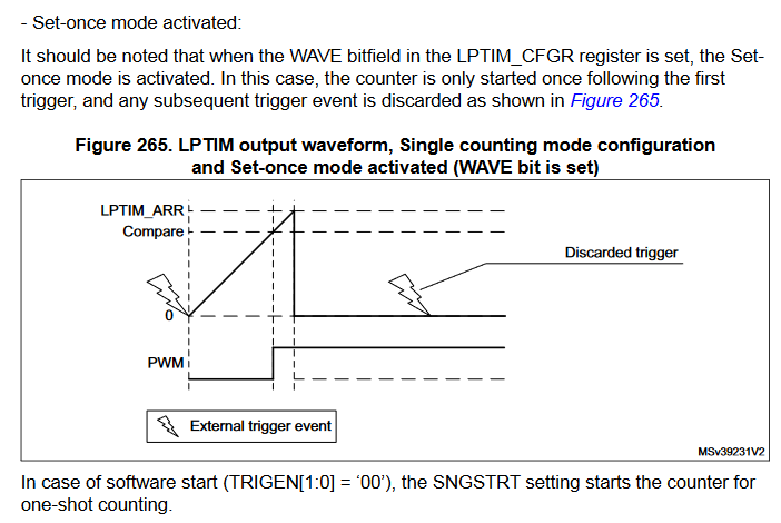

Try setting up WAVE bit in the LPTIM CFGR register to activate the set once mode (Fig 2).

2022-08-03 3:21 AM
Another plausible reason as to why it starts in continuous mode, you use the following function : HAL_LPTIM_TimeOut_Start_IT()
And when you take a look at the function definition there is : __HAL_LPTIM_START_CONTINUOUS(hlptim); in it. So you might want to use : HAL_LPTIM_SetOnce_Start instead.
2022-08-03 4:48 AM
Thank you so much @Community member
