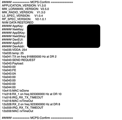

2024-12-10 11:10 PM
I have the same problem using the End_Node example, however I have had the Nucleo connected to the LoRaWAN network, it is just very intermittent in joining. I have changed LmHandlerSetSystemMaxRxError to (200) but this did not help.
I also cannot see any Join Request messages. Why might this be?

STM32WL Nucleo:
APPLICATION_VERSION: V1.3.0
MW_LORAWAN_VERSION: V2.6.1
MW_RADIO_VERSION: V1.3.1
L2_SPEC_VERSION: V1.0.4
RP_SPEC_VERSION: V2-1.0.3
0s041:TX on freq 916600000 Hz at DR 2
0s414:MAC txDone
5s398:RX_1 on freq 927500000 Hz at DR 10
5s449:IRQ_RX_TX_TIMEOUT
5s449:MAC rxTimeOut
6s410:RX_2 on freq 923300000 Hz at DR 8
6s476:IRQ_RX_TX_TIMEOUT
6s477:MAC rxTimeOut
10s048:TX on freq 917800000 Hz at DR 2
10s050:Payload:
10s421:MAC txDone
15s405:RX_1 on freq 926300000 Hz at DR 10
15s456:IRQ_RX_TX_TIMEOUT
15s456:MAC rxTimeOut
16s416:RX_2 on freq 923300000 Hz at DR 8
16s483:IRQ_RX_TX_TIMEOUT
16s484:MAC rxTimeOut
