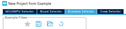

How are you testing the example, just opening it in your repository folder, or using the "example selector" included in STM32CubeMX / STM32CubeIDE available in a dedicated tab of the Finder tool that open when you create a new project ?
Using this Example Selector, it should create a local copy of the example in your own user folder containing all dependencies.
If it doesn't work like the theory, let us know.

Hi @Herve PIERROT, thanks for the quick answer.
Yes, I'm using the cubeMx example selector.
The error is on me, the files logo in eclipse appears as "links" but the files are in the workspace.
I suppose that they are links because the project explorer view does not match the file tree on disk...
Thus I can work from this example directly I suppose.
