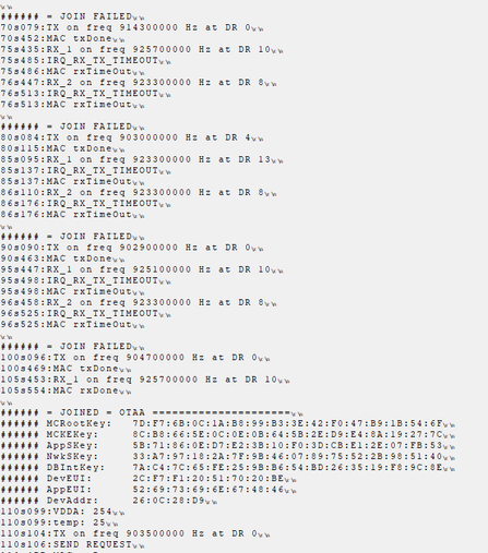

Thanks VicR I was able to use the last version . I replace all the files from patch to the main cube folder .
However I've noticed that the join fails too much . The old code was failing less , but both never join at the first try. Do you know if there's some configuration or procedure that could be missing ?
I'm using TTN and the most of the try that you can see above not even appear in the dashboard logs . After the joining the next messages arrives without problem .
So far I'm reviewing timeouts and RX windows but it's weird why with the old fail the first time as well.
I need that it works for the first time and also save the context to save power . This way the device can then just send the data and no waste time joining.
