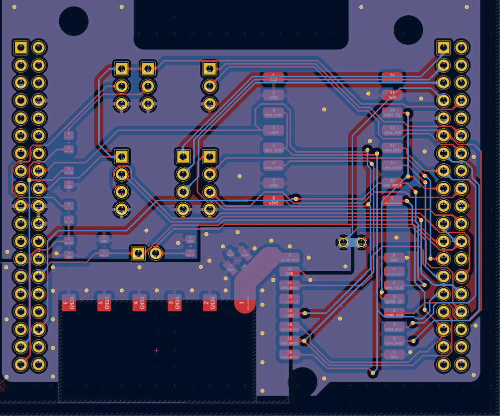

Here the schematics. The RFM is on the bottom right.

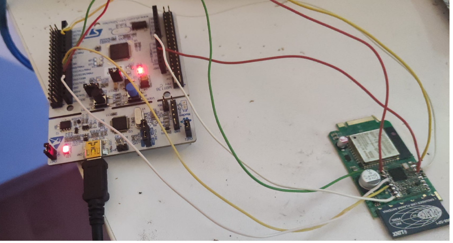

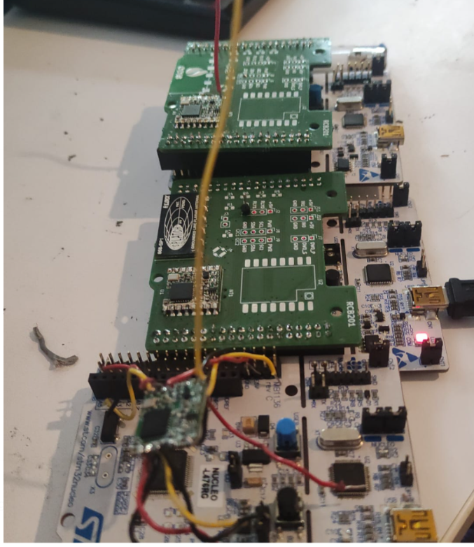

Here some pictures. I tried different RFM on the boards, and also just attached by cables with the Nucleo. The result is always the same.
Any help would really be appreciated, i do not know what else to try
2022-06-08 8:04 AM
I also tried to bridge one of our older boards. When i drive the RFM via the ESP32 on that boars i get messages with around -40RSSI.
When i drive the same RFM via the Nucleo, i oly get -115RSSI and just around 1m range
