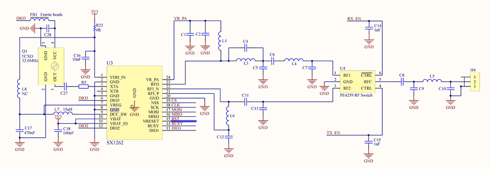

My custom board supports both RFM95 and SX1262. I was hoping that at least one of the two works out of the box with icube lorawan.
I dont have a logic analyzer here, so i will continue the tests with the RFM95 next week and post updates in my thread.
Here I'm using a "core SX1262" module which is the SX1262 with an RF-Switch. I got that part figured out.
Here i see that the chip is working, i get the Join requests on the Gateway with very good rssi. The problem is that on the firmware side i always get a "TxTimeout", which is connected to the event of the GPIO1. I see that the pin goes up as soon as the transmission is over, but the IRQ is never triggered.
