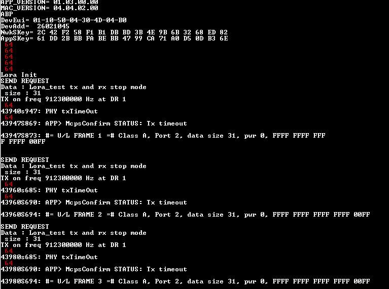

I have connected a Nicerf SX1262 us915 lora module with the STM32L496RG MCU. Lora module has DIO1 and Busy pins for tx and rx confirmation(data send and receive ).
I'm using STM32CubeExpansion_LRWAN_V1.3.1 library and i have used sx1262 example which is sx1262dvk1das. This code is properly working and its generate also interrupt on dio1 and busy pins at exact time but its occurs tx timeout or give on serial port window txtimout. I also get proper data on my gateway and server which is on ttn.
I dont know where is the problem. Interrupt fired on proper time. I checked all physical connections which is properly connected. I'm sharing my serial window data. where 64 is dio1 pin interrupt. .

2020-12-08 9:09 AM
Not sure why the TX would timeout unless the packet size and data rate (spread, bw, etc) completely underestimated the time-on-air, or the packet dispatch/buffering didn't actually succeed properly.
Might look at the dwell times for the SPI CS, and the slew rates on the SPI interface pins.
You're going to have to unpack what state the SX1262 is in, and flow/sequence of data into it.
The DIO interrupts should come in via EXTI configuration of the GPIO pins, and it should be reasonably easy to track those, or reflect state to another observable GPIO pin, or scope.
