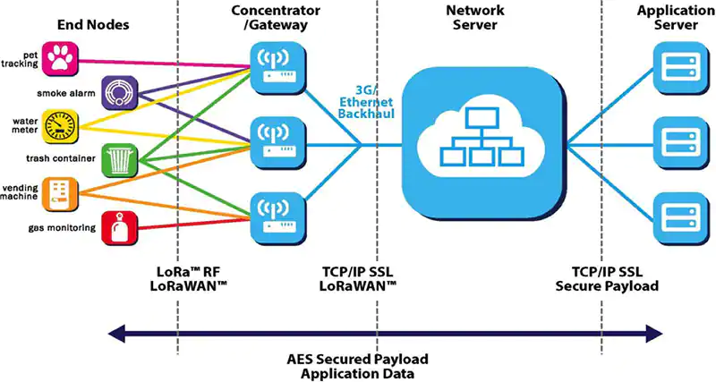

Yes, LoRaWAN® is strictly the "star of stars" structure with Nodes, Gateways, Servers, etc - defined by the LoRa Alliance:
https://lora-alliance.org/about-lorawan/
As @Danish said, look at the "Ping-Pong" example for simple peer-to-peer LoRa comms.
