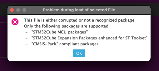

Then when trying to install the I-CUBE-LRWAN packeage into CubeIDE it gives the following error after selecting the zip package:

Hello @KMill
For the I-Cube-LRWAN, it is not compatible with CubeMX. You can't add it to CubeMX and use directly throw it. You should add it manually to your project.

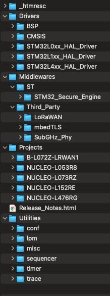

I download the ZIP and extract it.
It contains a bunch of folders, and drivers, and all kinds of goodness, which looks exactly like the structure of an expansion pack. Which are normally added via "Manage embedded software packages"
What it does not conatin is a bunch of source files.
I must have missed some detail on how to work with these expansion packs, which is why it would benefit from a read.me at least. Or I need to go back and learn what I missed!!

Hello @KMill
The available support is the UM2073 that should be really helpful for the first steps. For the implementation, I think you should follow the implementations of the examples already available on the package.

Just try to follow one of the Examples and how the functions are integrated there and that should do the job for you.
