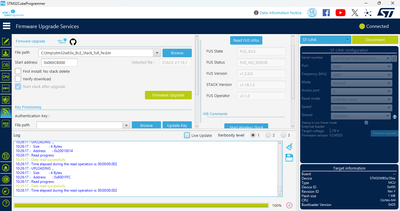

2024-11-01 6:50 AM - last edited on 2024-11-01 7:30 AM by mƎALLEm
Estou usando o STM32WB55cgu6, faço a gravação pelo CLI:
I'm using the STM32WB55cgu6, I record via CLI:
STM32_Programmer_CLI.exe -c port=usb1 -fwupgrade \tmp\stm32wb5x_BLE_stack_full_fw.bin 0x080CB000 firstinstall=0
STM32_Programmer_CLI.exe -c port=usb1 -d \tmp\bootloader_110.bin 0x08000000 -v
STM32_Programmer_CLI.exe -c port=usb1 -ob rdp=0xBB -ob displ
Quando vou conectar com o USB no PC ele não conecta, meu bootloader fica piscando um led indicando que posso fazer a gravação do meu firmware pela USB, mas não reconhece.
When I try to connect the USB to the PC, it doesn't connect, my bootloader keeps flashing an LED indicating that I can record my firmware via USB, but it doesn't recognize it.

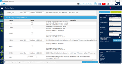

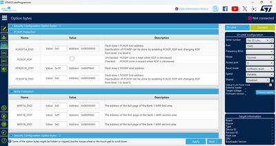

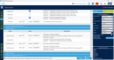

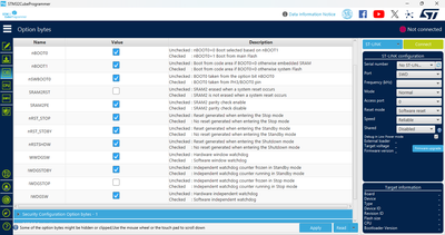

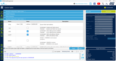

2024-11-01 7:08 AM
First, please write your comments in English to make it easier to understand. Also, make sure to write your SFSA value and take a picture of your board (with the USB cable in).
Best Regards.
STTwo-32

2024-11-01 7:37 AM
No problem for me, it’s easy to send in English because I use COPILOT to translate. I sent the SFSA print with the values, what is the function of the SFSA?

2024-11-01 9:04 AM
Yes, but the software I use for programming was developed to fetch data directly from my company's server, and they also developed this software. For this reason, I want to establish communication directly between the USB on the board and the USB on the computer. However, it seems that an error occurs in this part and it does not communicate.
2024-11-01 9:31 AM
Why are you using Cube Programmer then. If the problem is not related to the Cube Programmer, please create a new ticket for the new case with a better description if possible (after selecting a "accept as Solution" for this post).
PS: don't forget that the right starting address is 0x080CE000 and not 0x080CB000 as mentioned on your second command (for the stm32wb5x_BLE_Stack_full_fw.bin). I think that this may be the source of the problem.
