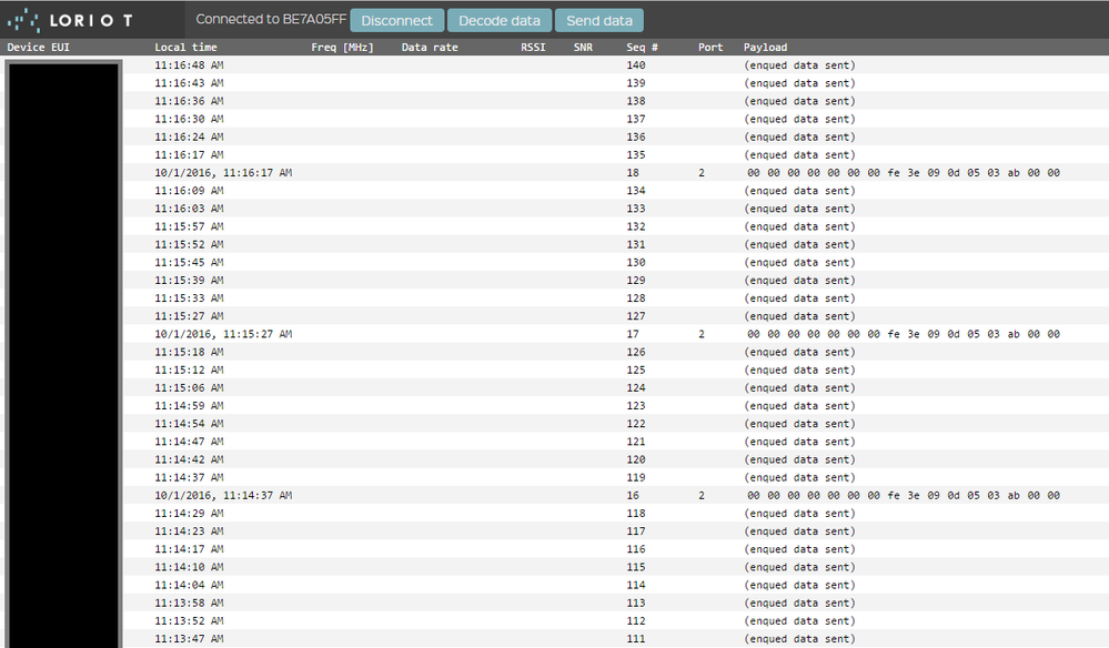

We started development of a LoRaWAN Sensor with the I-CUBE-LRWAN software stack in combination with a NUCLEO-L152RE and SX1272MB2DAS expansion board.
I have made the following changes to the code after a clean download:
- Changed commissioning.h file to do ADP with my Lorank8 gateway
- Disabled dutycycle in lora.c:81
- Enabled LORAWAN_CONFIRMED_MSG
No what I expect from the code is to receive the confirm message send from the gateway in RX2. I checked with a IMST LoRaWAN node to check if the downlink message is actually send by the gateway but this node receives the downlink confirm message in RX2 without problem (This node uses a STM32L1CB MCU and runes this software: https://github.com/Lora-net/LoRaMac-node).
But the issue is the almost unchanged I-CUBE-LRWAN software doesn�t receive anything in RX2. It does receive in RX1 fine.
My guess is it has something to do with the L152RE MCU type.
I use Keil to compile and flash the software.
See my Loriot.io log below. As you can see the Node doesn�t receive the ACK and will retransmit for 8 times and then continue to the next sequence number.

Looks like we solved it by changing the bitrate for RX2 to the right one.
