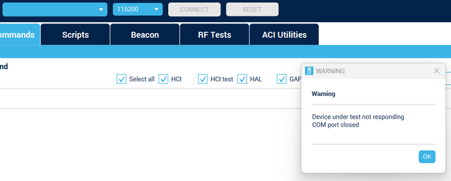

I'm using the board STM32WB05KZ and i installed STM32CubeMonitorRF to connect to the baord (Mode BLE)
But i received a notification that i can't connect to the board

Hello @ljm
Could you please try to follow those steps:
  1. Upload the BLE_TransparentMode.hex to your board.
  2. Open the STM32CubeMonitor-RF PC tool and set the com port to the one of your board.
  3. Set the baudrate to 921600
  4. Click on Connect.
That should work fine.

Hello
thanks for relying
it works thank you very much.

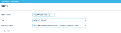

one last question please here why "Get RSSI" is locked ? i want to get the RSSI value
thanks
