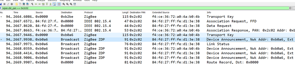

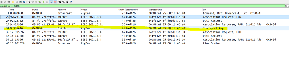

status = ZbStartupWait(zigbee_app_info.zb, &config);Here's an image of the sniffed network messages. There isn't a 'Device Announcement' message after the 'Transport Key' message:
I have successfully connected the same bulb to a different (non-STM32) coordinator. The sniffed traffic in this case shows a 'Device Announcement' after 'Transport Key': (I think this proves the bulb is working ok)
