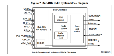

2024-07-17 3:54 AM
No.
Usually you want/need for GHz or many-MHz PLL a very stable clock source, typical a crystal.
See basic:
HSE32 is the "standard" clock for the PLL. (If 20 ct for a crystal is too much, you have another problem...)

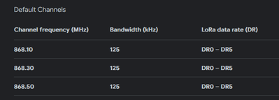

2024-07-17 5:23 AM
Ok, but you still want receive it - right ? :)
So:
The fequency should be, where you set it to - lets say- 0.01 MHz, 10kHz tolerance , to get it working at a channel bandwidth of 125 kHz.
THIS alone gives about 11 ppm max. tolerance, so even should be a +/- 10ppm crystal, not the cheapest 50ppm thing. And about the RC "reference" ...
... 10 000 ppm away .... you wouldnt even know, on which channel you sending. :)
