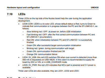

But besides a comprehensive description of power supply option, the meaning of onboard LEDs is listed :

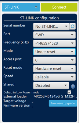

I suggest you connect the board to the STM32CubeProgrammer. After that you can try to connect under reset.:
After that, you can perform a mass erase using this option:
Disconnect From the programmer and try to upload your FW throw your IDE. It should work.

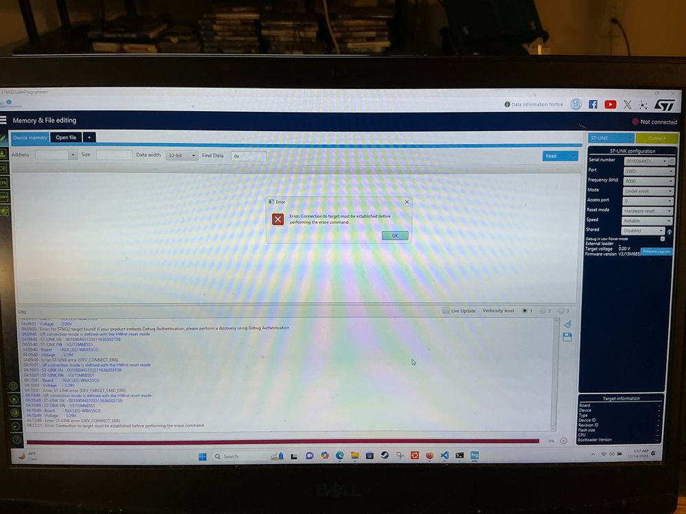

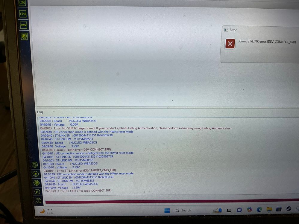

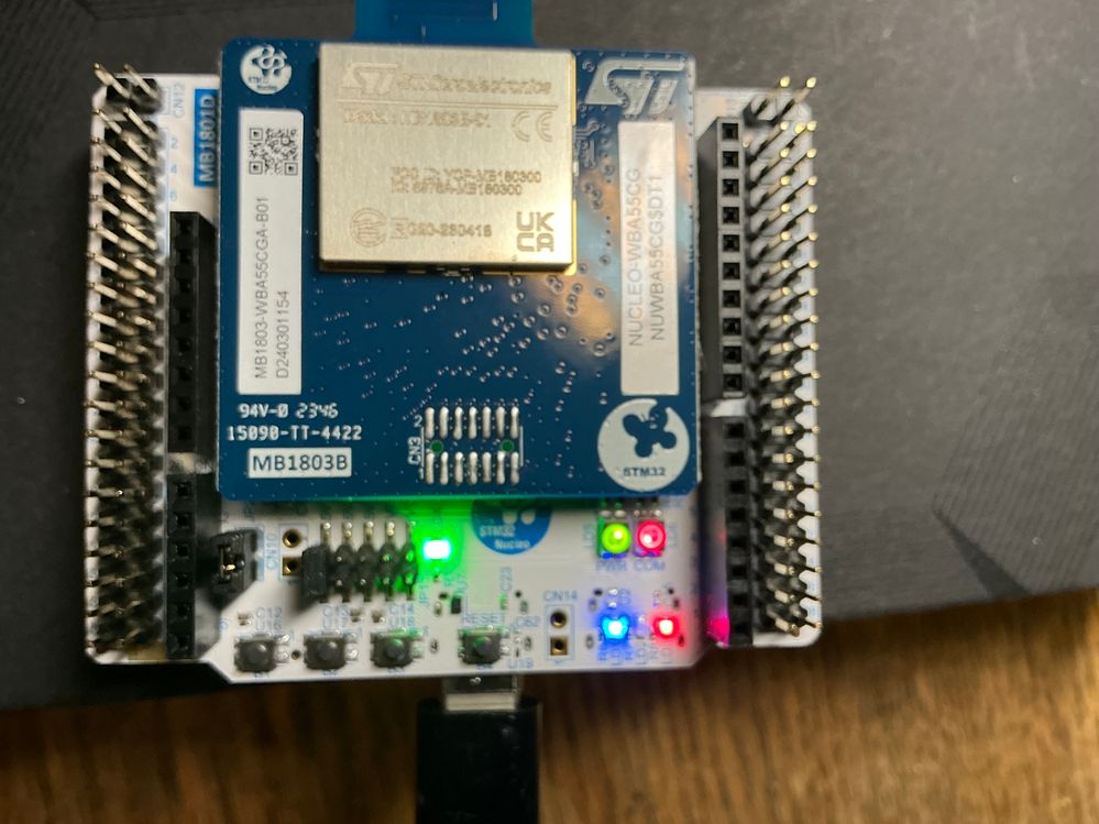

Good morning and thanks for replying. I have tried what you’ve suggested and I will send pics of the results. I have downloaded the file that Ozone suggested earlier but that lead to the P-NUCLEO-WB55. Mine is the NUCLEO-WBA55CG. I’m not sure how similar or different each board is, as this is my first ST product but I figured I would respond before looking up the docs for my board. Are my jumpers in the correct configuration if you can see them in the pics? Should I change the frequency? I don’t know at this point but i will go over the docs but I also have to go back to work as my weekend is Tuesday and Wednesday not much time for trial and error. Any help is greatly appreciated!

Since the ST-Link is up and several LEDs are on, the board hardware seems fine.
A power/hardware failure of a discovery/nucleo board used to end up in a red or orange LED permanently on. Which is not the case here ...
I would check section 7.6 of the user manual, "Programing/debugging when the power supply is not from USB ST-LINK (5V_ST_link)". Especially in respect to the jumpers und solder bridges mentioned there.
