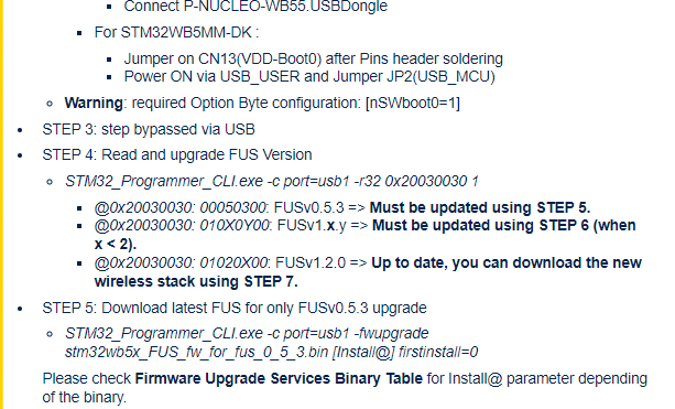

The steps performed:

Then am not able to read the FUS version..

When I completely erase the chip and then tried to read the FUS version via USB still am not able to read FUS version
2023-04-06 12:12 AM - edited 2023-11-20 9:04 AM
As per STEP 4, the FUS version should have been read irrespective of anything, but when I erased the chip completely am not able to read the FUS version via USB.

Right now the chip has been erased completely.
Do you know how to enable the cortex M0+ before reading the FUS version via USB?
2023-04-10 6:28 AM
Or In other way of asking, Is there any way to start FUS without making the nswboot0 = 0 via USB?
