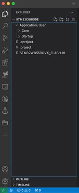

I have the cmake extension installed. I can open up the folder STMCUBEIDE within the BLE/heartrate folders. But when I try to import a local project I get the following error message: Project importing failed. ENOENT: no such file or directory, open '/Users/remyhurx/Documents/STM/Library/STM_Firmware/STM32CubeWB/Projects/P-NUCLEO-WB55.Nucleo/Applications/BLE/BLE_HeartRate/.cproject'
I see the .cproject in the STMCUBEIDE folder, the IOC file is located one up in /Users/remyhurx/Documents/STM/Library/STM_Firmware/STM32CubeWB/Projects/P-NUCLEO-WB55.Nucleo/Applications/BLE/BLE_HeartRate/
The .cproject is in /Users/remyhurx/Documents/STM/Library/STM_Firmware/STM32CubeWB/Projects/P-NUCLEO-WB55.Nucleo/Applications/BLE/BLE_HeartRate/BLE_HeartRate/STMCUBEIDE

Yes, I see the core project file in the "Root" directory of the BLE Heartrate project but to build the STM32CubeIDE specific project you want vs code to be in the STM32CubeIDE directory.
The project Core files are in the Root so you would have to open another Vs code instance at the root directory but build from the STM32CubeIDE directory.

Fails at this point. After opening up the folder stm32cubeide in the ble heart test example folder, I go to the stm32 extension. Choose import a local project and go one folder up to select ble_heartrate.ioc
The returning error: Project importing failed. ENOENT: no such file or directory, open '/Users/remyhurx/Documents/STM/Library/STM_Firmware/STM32CubeWB/Projects/P-NUCLEO-WB55.Nucleo/Applications/BLE/BLE_HeartRate/.project'
This file is in the already opened folder, but it doesn’t read. So it fails before I can do step 3 etc.
I tried to add the higher folder (with the.ioc) to the workspace, with the same result. So I didn’t had the chance yet to do step 3 or 4.

This is not what i said in step 2. I said import .project NOT ble_heartrate.ioc . Forget about ble_heartrate.ioc that is for editing configurations in CUBE IDE and you dont want to use that.
At this point I would delete the V1.18.0 and have cubeIDE download it again because who knows what VS Code and Cube have modified. And then try to follow the steps as I wrote them
2024-03-19 2:17 PM
Thx, it worked out now. I’m sorry, not used to the ST structure yet. The .project was also hidden (macOs). 👍🏻
