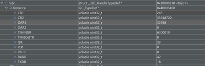

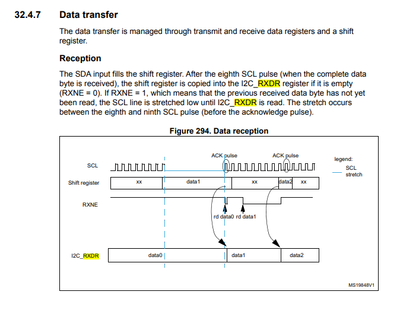

2024-02-08 3:17 PM
The manual describes this exact behavior is RXDR isn't read. Specifically that SCL will stretch between and 8th and 9th bit. However I am seeing the callback in the hal read from RXDR yet nothing happens on the line:
