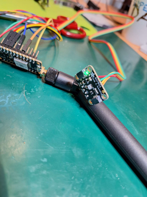

I2C doesn't see device:

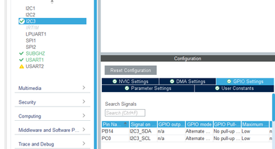

According to the MX configuration, I2C3 has the following GPIO:

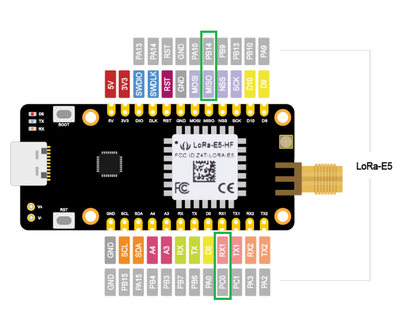

According to the WIO Lora E5 Mini wiki, I see that these pins are
PCO => RX1
PB14 => MISO
The Green LED on the SI7021 fires.
I checked the connections between LORA and this sensor many times, and all look good.
The ST-LINK V2 is attached to the LORA device too.

That board is clearly labeled with SCL and SDA which is I2C2. So it's PA15 and PB15 that needs to be used.
By default when enabling I2C2, it chooses PA12 for SCL. So you override it and choose PB15 for SCL.

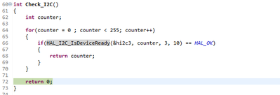

There are 7-bits in the I2C address used, the high order bits. You should be cycling 0..127 with counter<<1 passed as the address. Address of SI7021 should be 0x80 from ST perspective (0x40 << 1)

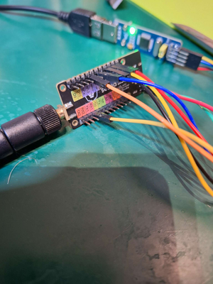

Enumerating what you've wired to what. Pictures help, but have to decipher colours, and placement
Would expect to need VCC,3V3,SCL,SDA,GND minimum. If providing VCC, check the voltage at 3V3 pin for drop-out
https://www.sparkfun.com/sparkfun-humidity-and-temperature-sensor-breakout-si7021.html

@Karl Yamashita I choose I2C3, so PC0 and PB14 will the pins to connect.

@TDK According to the MX documentation for this chip under the STMCubeIDE, these GPIOs (for I2C) don't need any pullups or pulldowns.
I have several sensors attached to the LORA devices without those pulls.
