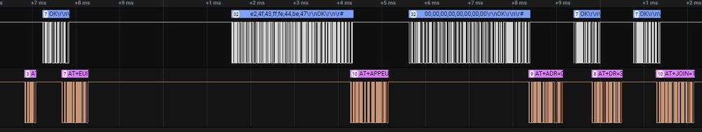

I just bought a LRWAN2 pack, I was able to connect the gateway to the TTN network and application server. But the APPEUI i the join request was wrong (only zeroes). So I plugged an oscilloscope on the RX and TX pins an it shows that:
Does this mean the LRWAN1 board is dead?
