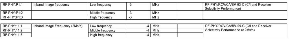

Here are the values for 1 and 2 Ms/s
2021-02-16 3:36 AM
Great, thanks for this @Remi QUINTIN , is there a document that has these and other PIXIT / IXIT parameters specified?
2021-02-16 4:51 AM
Informations regarding the frequency are in the Datasheet ( Table 28. RF receiver BLE characteristics (1 Mbps) & Table 29. RF receiver BLE characteristics (2 Mbps) ).
All IXIT informations that descrive how the certification is performed are in the official certification report (see Appendic C in the joint document).
