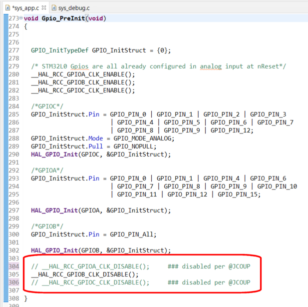

'To solve the hard fault (I do have to check completely why) do disable the debug mode ( in sys_app.c the DBG_Init() function). In addition in the Gpio_PreInit() function put in comment the two "__HAL_RCC_GPIOA_CLK_DISABLE()" and "__HAL_RCC_GPIOC_CLK_DISABLE() " statement.'
If I do that, I still get no AT Command transmitted and, because the debug connection is now disabled, I cannot see what is happening - whether it's Hard Faulting or not!

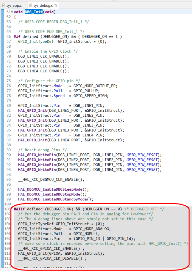

Disabling these lines in Gpio_PreInit():

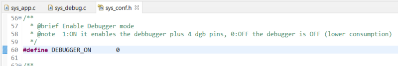

I've disabled Debug:

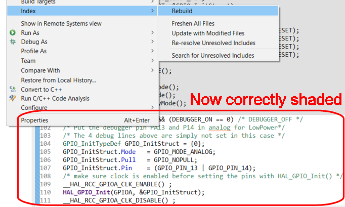

But the CubeIDE highlighting doesn't recognise it:
0693W00000BdaZdQAJ.pngAlthough stepping in the debugger does show that it executes the greyed-out code!

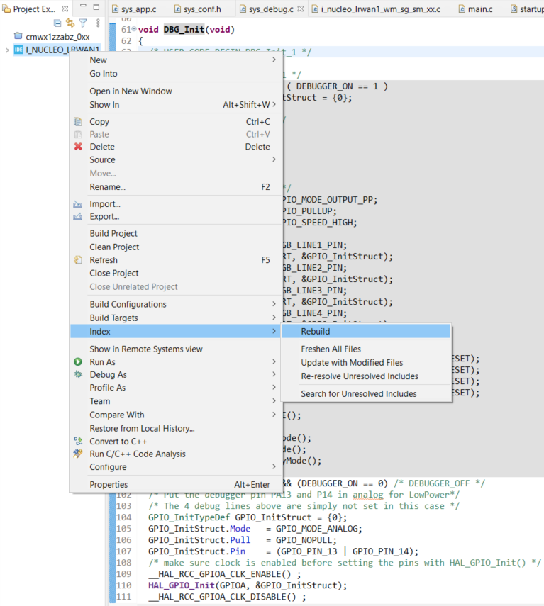

How do I re-sync the highlighting in the CubeIDE? Closing & re-opening didn't help.
EDIT
Found it:

The code is building correctly - it is doing the "DEBUGGER OFF" part - it's just the IDE that was incorrectly shading the source in the editor.
This was fixed by doing the Index > Rebuild:

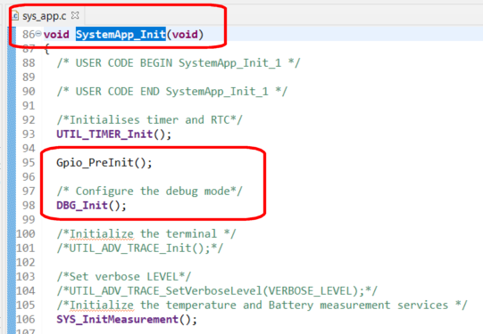

If I comment-out the call to DBG_Init():
  * @brief initialises the system (dbg pins, trace, mbmux, systiemr, LPM, ...)
  * @param none
  * @retval  none
void SystemApp_Init(void)
  /* USER CODE BEGIN SystemApp_Init_1 */
  /* USER CODE END SystemApp_Init_1 */
  /*Initialises timer and RTC*/
  UTIL_TIMER_Init();
  Gpio_PreInit();
  /* Configure the debug mode*/
  //DBG_Init();	                   	### disabled per @JCOUP
  /*Initialize the terminal */
  /*UTIL_ADV_TRACE_Init();*/
  /*Set verbose LEVEL*/
  /*UTIL_ADV_TRACE_SetVerboseLevel(VERBOSE_LEVEL);*/
  /*Initialize the temperature and Battery measurement services */
  SYS_InitMeasurement();
Then I do se one AT Command sent:

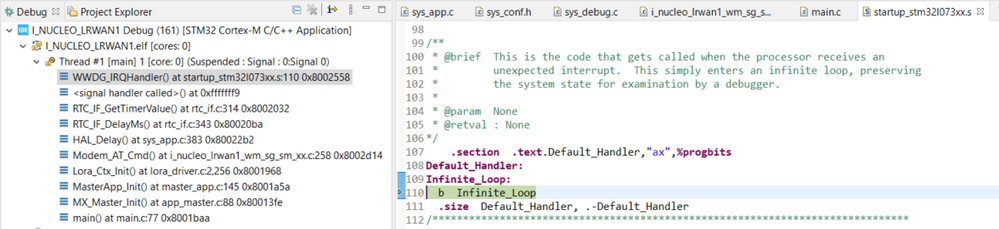

But then nothing more happens.
If I halt the debugger, it's in the Default_Handler again - another Hard Fault ?
Maybe it's not actually a Hard Fault - some other unhandled interrupt ... ?
