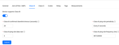

2025-03-17 9:04 AM
Hi everyone,
I'm working with an STM32 B-L072Z-LRWAN1 board and a Lorank8 gateway (Beaglebone + iC880a concentrator), using the I-CUBE-LRWAN expansion software package.
I have successfully implemented Class A and Class C with Chirpstack and TTN, but I’m facing issues with Class B: I cannot receive any beacons at all.
This is what I get in the end-device logs:
It seems that the device is trying to listen for beacons, but it never receives one.
This is the gateway log:

And my Chirpstack config:
Has anyone encountered this issue before? Could this be a problem with my gateway configuration, or am I missing something in my end-device setup?
Any help or suggestions would be greatly appreciated!
