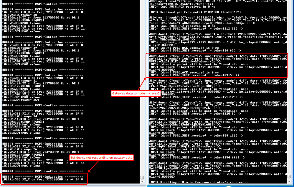

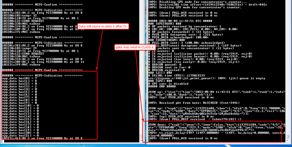

#define LORAWAN_DEFAULT_CLASS CLASS_C(https://github.com/gotthardp/lorawan-server/blob/master/doc/Handlers.md#downlink) Form this reference link. I am sending my data on my node via CLASS_C and CLASS_A mode.
CLASS A JSON
"data":"07080001000000000000000000000000000000000000",
"port":2
}CLASS C JSON
"port":2,
"time":"immediately"
}when is sent data on my module via class A it works.
In CLASS_C I expect an immediate response because the RX window is always open in class C.
In my log, I observe that my RX window is open after TX.
when is sent data on my module via class C it's not working.

My node's CLASS_C Rx window will be open but I didn't get any response from the controller side. but in getaway send data to node successfully.
In CLASS_A. data received in the gateway to the node.
In CLASS_C. data not received in the gateway to the node.

when I configure Node with CLASS_A. bi-direction communication with node to "https://gotthardp.github.io/lorawan-server" works fine.
In CLASS_C my node will successfully data transmit to the server but I am not able to receive data from server to node.
