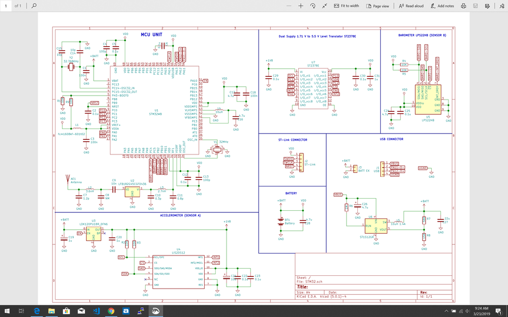

2019-03-22 7:28 PM
The schematic is as below:

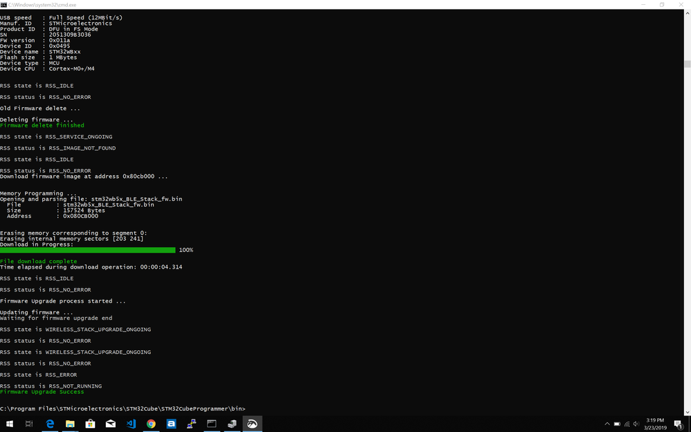

2019-03-23 4:55 AM
To update the firmware on CPU2 CM0+, do the following:
(1) Connect the Boot0 pin to VDD
(2) Using command line: STM32_Programmer_CLI.exe -c port=usb1 –fwdelete
(3) Next, write command:
STM32_Programmer_CLI.exe -c port=usb1 -fwupgrade stm32wb5x_BLE_Stack_fw.bin 0x080CB000 firstinstall=1
Result:
After that:
(1) put back the Boot0 pin to low (pulled down by 10K resistor to GND)
(2) connect to Nucleo board's ST-Link (SWDIO, SWCLK, NRST, GND, VDD 3.3)
(3) Use ST-Link Utility to flash the CPU1 CM4F with BLE_beacon binary
Check using ST BLE Sensor app, the beacon is still not found.
