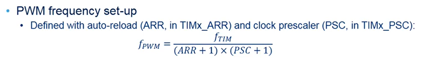

According to the following formula for PWM frequency, there is no possibility to reach a frequency of 1500 kHz.
The closest frequency which can be setup is 1,52381 MHz with F_tim = 32 MHz, PSC = 0 and ARR = 20.

CPU1 timer is clocked 64 and this formula is source for question.
I mean A is possible change clock to other value?
