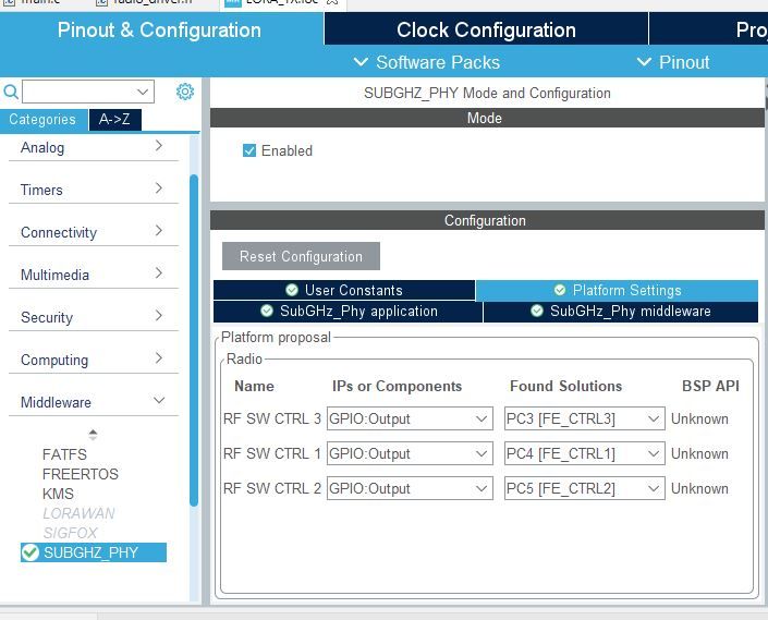

Hello, How to set RF SW CTRL pins? How to make them appear in platform settings of SUBGHZ_PHY configuration?

anyway they are controlled by BSP drivers
This is part of the drivers:
int32_t BSP_RADIO_ConfigRFSwitch(BSP_RADIO_Switch_TypeDef Config)
switch (Config)
case RADIO_SWITCH_OFF:
/* Turn off switch */
HAL_GPIO_WritePin(RF_SW_CTRL3_GPIO_PORT, RF_SW_CTRL3_PIN, GPIO_PIN_RESET);
HAL_GPIO_WritePin(RF_SW_CTRL1_GPIO_PORT, RF_SW_CTRL1_PIN, GPIO_PIN_RESET);
HAL_GPIO_WritePin(RF_SW_CTRL2_GPIO_PORT, RF_SW_CTRL2_PIN, GPIO_PIN_RESET);
break;

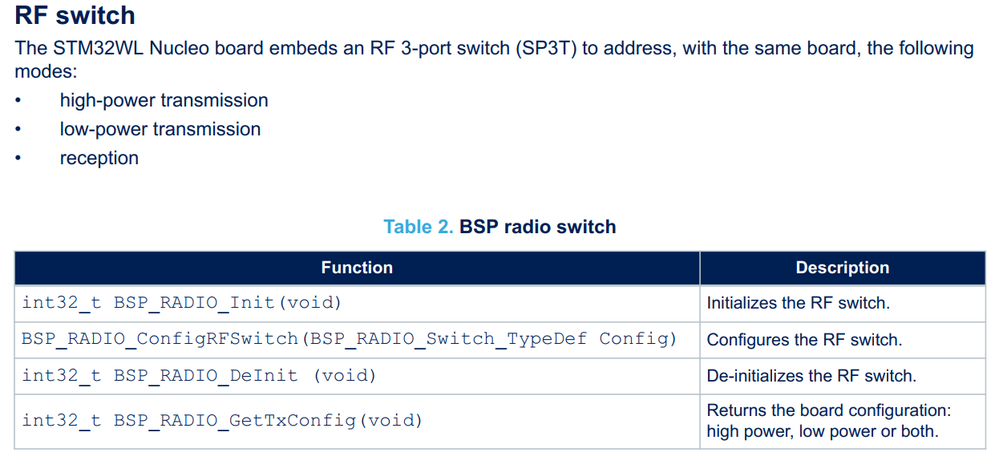

2021-09-24 2:27 AM
I think you should use the related API
as described on AN5406
F.
