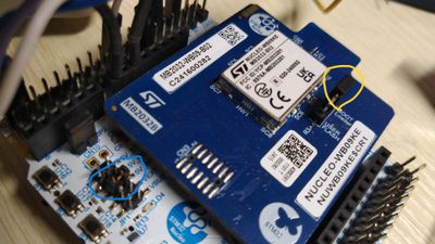

2024-12-23 2:30 AM - edited 2024-12-23 2:33 AM
JP1 on MB2032: 1-2 - Bootloader
JP1 on MB1801D:5-6 - 5V_INT
How about 5v, Vin or 5V_INT?
2024-12-23 2:32 AM
