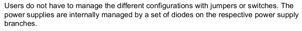

The above image is taken from the user manual of the same board. Where I am doing wrong?

The missing image is there below. this statement is right above the statement you shared.
I have gone through the schematic and I tried Closing (Fitting) the SB5 and it worked. Is it a bad approach?
