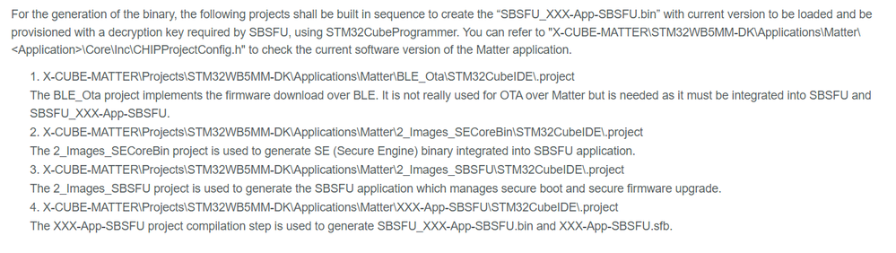

1. How can I generate .sfb file from my own project (e.g. XXX-App)?
2. Please tell me how to generate a User Key.

the overall process is, I think, pretty well explained in the wiki, mainly in section https://wiki.st.com/stm32mcu/wiki/Connectivity:Matter_develop_and_prototype#How_to_perform_remote_firmware_update_.28OTA.29_over_Matter
To use OTA with your own application, you would need to replicate the exact project structure as in the examples (Lighting-App-SBSFU). This can be quite complicated at first - so I would suggest starting from e.g. Lighting-App-SBSFU project which has all the necessary bits implemented. Make a copy of the whole folder, then you can make changes according to your specific application.
.sfb file is generated at the end of the compilation process (by a post-compilation script) as explained here
If by use user key, you mean the key used for encryption, then you can refer to this manual Integration guide for the X-CUBE-SBSFU STM32Cube Expansion Package - Application note chapter 5.1.
