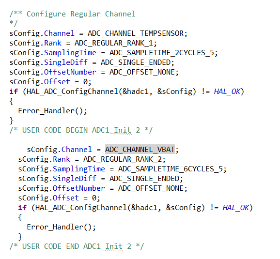

2022-08-17 6:40 AM
Thank you for your answer.
Just to be sure, I add the configuration of the rank 2 (for example) that enable my channel VBAT as shown in this picture ?
2022-08-17 6:59 AM
Yes, but if the initialization is sequenced like this, you don't have to repeat intialization of structure members that don't change from the last rank.
For internal channels, see the example internal channel projects available for recommended sample times. They are typically much higher than what you are using.
Find a DMA ADC example to follow for two or more ranks.
Cheers, Hal

2022-08-26 11:28 AM
You need to adjust the SamplingTime for Temperature and VBAT channels. They are quite long.
-WQ
