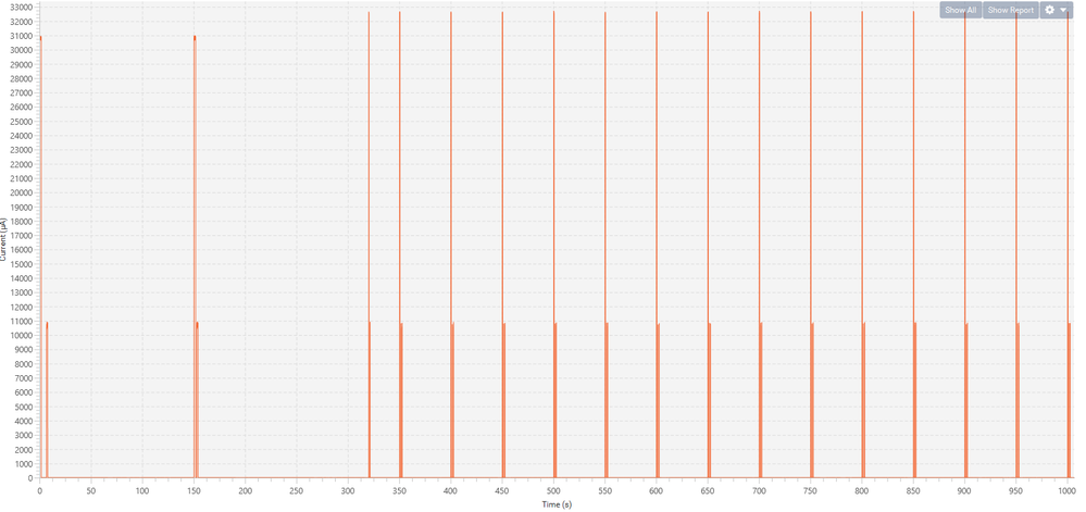

I set the dutycycle to 10 s :
#define APP_TX_DUTYCYCLE 10000But when i run the program i get this :
I join the network at first emission. Then i got two emissions at 150 s and 320 s and finally it becomes periodic but with a period of 50 s not 10 s.
It looks like the MCU is waking up every 10 s but it doesn't send data every time.
What is the problem and is there a way to fix it?

When the function send is called (every wake up / 10 sec) and nothing is send, I get the status LORAMAC_STATUS_DUTYCYCLE_RESTRICTED

2020-01-15 2:24 AM
Thanks for your answer.
If i understand well i can solve it by:
I found this site to calculate the time on air and the lost duty cycle: https://www.loratools.nl/#/airtime
In the i-cube-lorawan software, do the message have an explicit header and a CRC ? It affects the size of the message and therefor the minimum dutycycle allowed!
