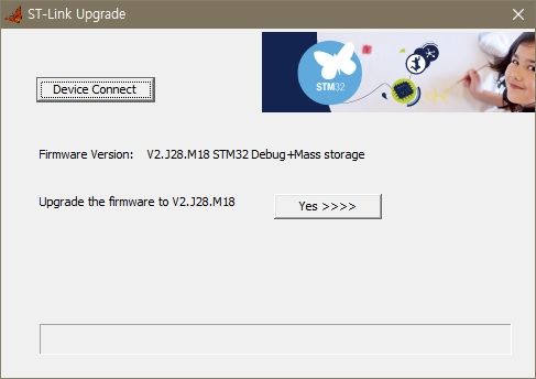

I had problem at STM32F401 Nucleo board.
I solved it with ST-Link F/W update.
