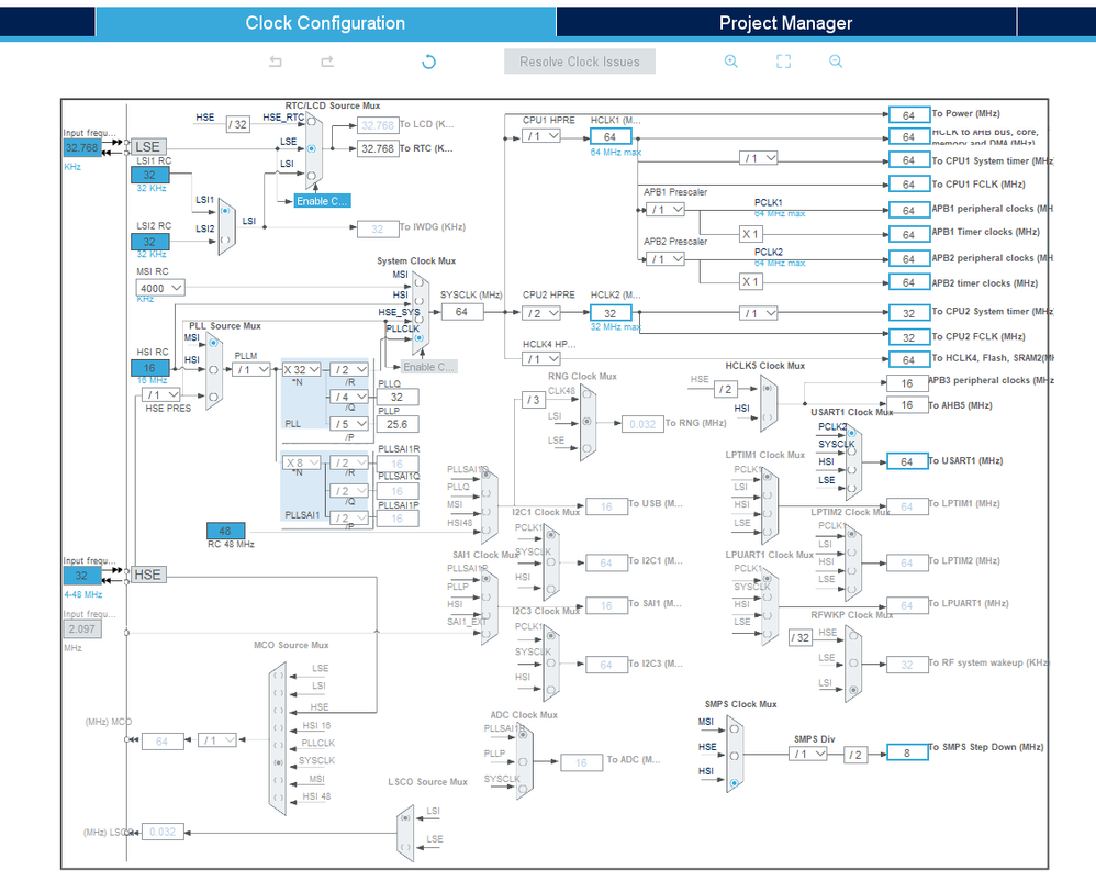

It lose time in continuous and i use this clock configuration:
2019-03-25 5:26 AM
So check the quarz. Maybe it is 32 k and not 2^15. Or maybe the load capacitance is far off. Or it is broken...
