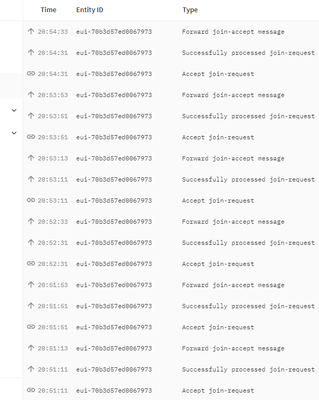

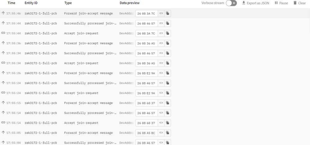

The module is joining successfully to the network server, as it can be seen
TTN server endSo, I guess the Sub_Ghz / RF section is working fine, but the MCU section is not receiving any successful Tx return status from the RF sectiono, so it is trying to join again and again

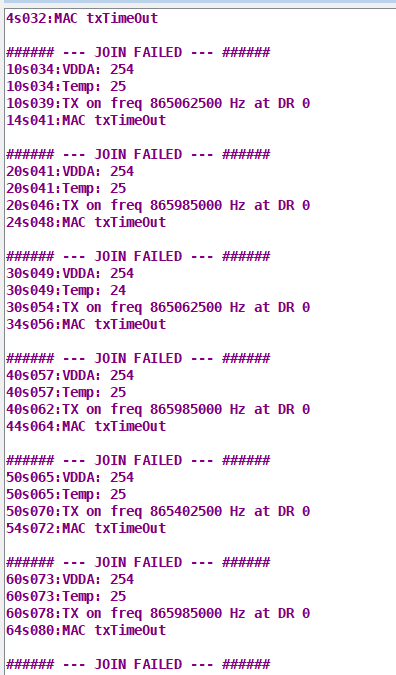

Serial log of module
What could be the possible issue?
