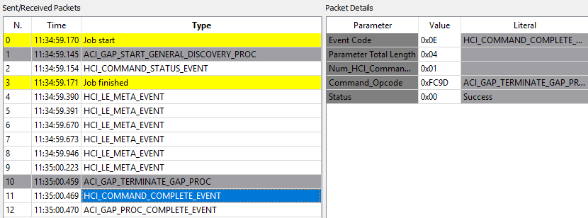

Winfred LU
ACI_GAP_TERMINATE_GAP_PROC shall work.
Attached the screenshot terminating the scanning after 1 second.
Aishwarya
Associate III
yes @Winfred LU
Open Winfred LU Preview
 I fallow the same steps but aci_gap_terminate_pro(0x02)  function returns status ERR_NOT_ALLOW.
