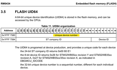

2024-07-23 5:45 AM
If your intention is to generate a unique number to identify the device, I suggest using what's already onboard for that. The UID64 register value is guaranteed unique for each device.
Barring that, there certainly are ways to save information. Saving to a flash sector can work, as can saving to SRAM if power is not lost.
2024-07-24 1:04 AM
Hello. @TDK
Thank you for your reply.
Thanks to you I have a better understanding of UID.
This time, however, I would like to add a process to change the random static address when a new connection is initiated after this (pressing the pairing button again during pairing).
Therefore, I don't think UID can be used only for identification (not sure if this is correct, sorry).
I'll think about how and when to save it to flash some more. Thanks.
Best regards.
