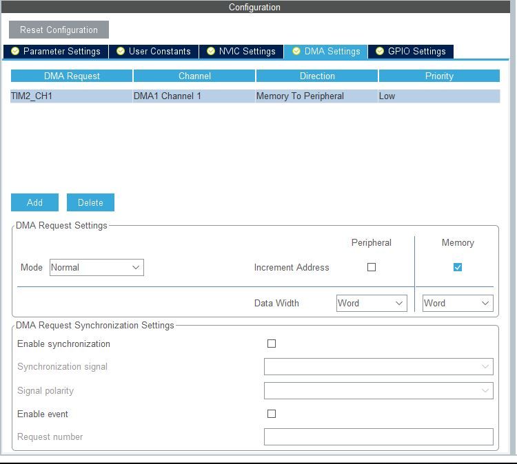

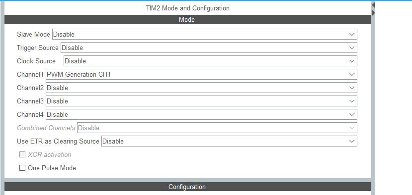

I create a simple project with CUBE_MX in order to test DMA_PWM generation.
I configure the TIM2 like this :
The DMA is configured this way:
in the main i fisrt enable the PWM channel(signal output is ok on scope) , then i try to start a DMA transfer to set the duty cycle to 10(buffer values) ..but when i check the duty cycle is still 40 (like it was at the timer initialisation)
So i think there is no transfer.
I'm quite new with DMA so i'm not sure my configuration is right...maybe i should not left DMA request synchronisation settings empty...?

2020-11-21 6:15 PM
Which STM32?
Read out and check/post TIM and relevant DMA registers content.
