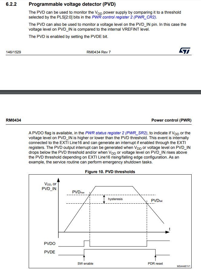

I am using the Nucleo WB55 Development Board, how do I set up the (Programmable voltage detector) PVD and get it to work?
2021-05-11 12:46 AM
Hello @Member ,
I advise you to read RM0434 : 6.2.2 Programmable voltage detector (PVD) section.
When your question is answered, please close this topic by choosing Select as Best. This will help other users find that answer faster.
Imen
