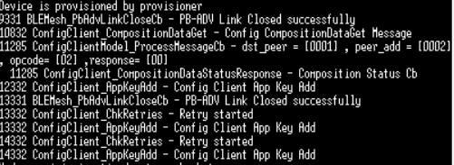

Hello EMECH,
The above changes respond back on terminal:
ConfigClientNodeReset- Config Client Node Reset message
dst_peer= ,peer_add=...........................
if we do not reset the LPN board (Dongle) and change the Provisioner (another STM32WB Nucleo Board hardware. which create new network Appli_StartProvisionerMode(1);).
During Config Client Process it will get stuck below point..
0693W00000NsrhOQAR.pngOnce again if we reset the same LPN node (hard reset) (dongle) or NVIC_SystemReset();.
Scan again on terminal and restart the provisioning process. it is compiling the process. as shown below trace:
Appli_ConfigClient_ConfigureNode - **Node is configured**
my question is why LPN node require reset?
we don't want reset in security application...
I hope you have tested before releasing new version.

Hello EMECH,
After following above modification. Still we are facing same problem from second STM32WB Nucleo board..
0693W00000Nt7arQAB.png------------------------------------------------------------------------------------------------------
First STM32WB Nucleo Board Response:..
32293 ConfigClient_NodeReset - Config Client Node Reset message
 Request to Unprovision:2
32329 ConfigClientModel_ProcessMessageCb - dst_peer = [0001] , peer_add = [0002], opcode= [804A] ,response= [00]
 32330 ConfigClient_NodeResetStatus - ConfigClient_NodeResetStatus Received
LPN Board Response this:
Device is unprovisioned by provisioner
if we reset LPN (Dongle) Board then restart provisioning process from second STM32 Nucleo Board again it will config Client App Key Add properly..
Best Regards
Deepak Aagri
