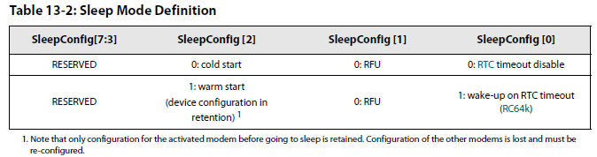

You can configure the device to keep in retention the config of the chip and restore it when you will leave sleep mode.
This can be done using the following function in radio_driver.c :
void SUBGRF_SetSleep( SleepParams_t sleepConfig )
You have to set the parameter at the index 2 at 1 to enable this feature.
I suggest you to refer to the Reference Manual RM0461, section 4.7.2 about Sleep Mode of the radio to have further information.
