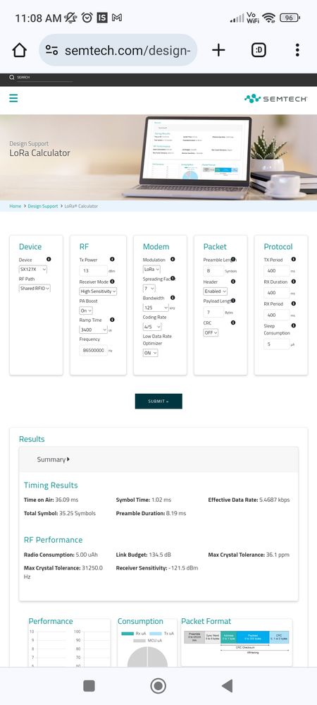

As of LORA calculator maximum speed that can be achieved is 5kbps using B-L072Z LRWAN1 board. But I'm not able to achieve that speed. I'm attaching a screenshot.
