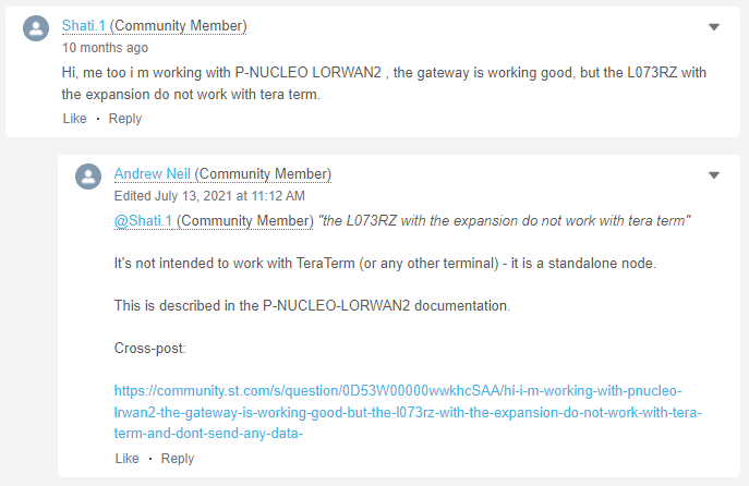

https://community.st.com/s/question/0D53W00000rauT3SAI/cant-make-at-master-application-to-work-on-nucleolrwan1nucleol073rz-pair
This stupid forum doesn't allow me to link to the specific post in the thread:
0693W00000NqAfZQAV.pngThat link goes to:
https://community.st.com/s/question/0D53W00000wwkhcSAA/hi-i-m-working-with-pnucleo-lrwan2-the-gateway-is-working-good-but-the-l073rz-with-the-expansion-do-not-work-with-tera-term-and-dont-send-any-data-

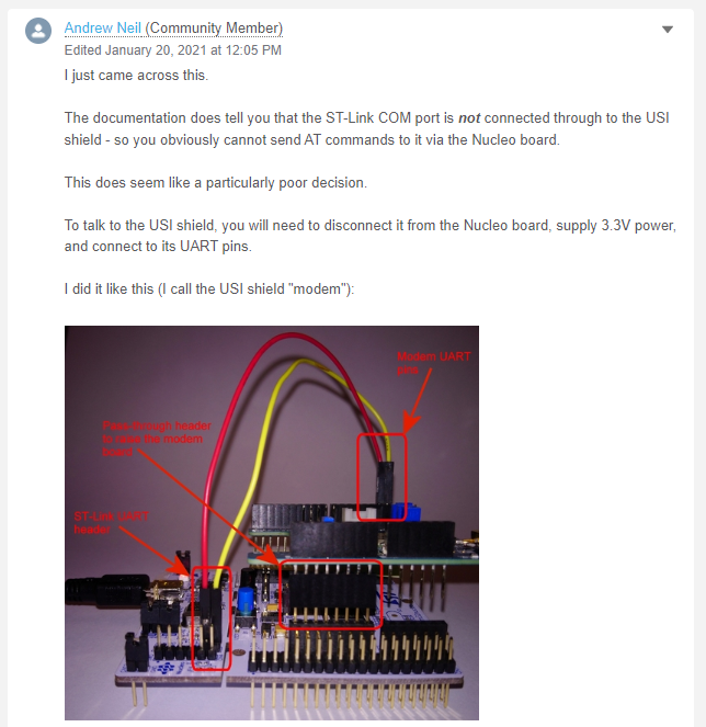

And, eventually, how to get comms directly to the USI module:
0693W00000NqAgXQAV.pnghttps://community.st.com/s/question/0D53W00000DHlVaSAL/i-want-to-get-pnucleolrwan2-gateway-source

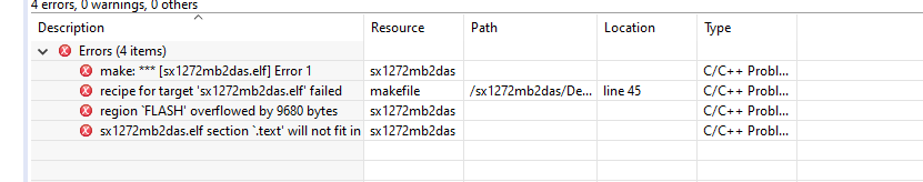

Its works! With package V1.2.2, but when enable the sensors and only temperature and humidity, there was FLASH overflowed 9680 bytes :(
0693W00000NqQX2QAN.pngThe size optimization is enable and debug disable. Any susgestions? I noticed
the package v2.1.0 dos not have the solution. of this board.
The USI board was generally panned several years ago, the LRWAN-DISCO using the Murata module was much better received having a newer SX1276 radio, and a larger 192KB FLASH L072 part, and a more open software stack. Many of us, including the FAE's, just reprogrammed the USI parts, having patched the LRWAN code ourselves. The patching mainly relates to the pining of the SX1272, and the RF side RX/TX switching gate. If v2.1.0 is too bulky to fit, you might need to make alternate choices.
