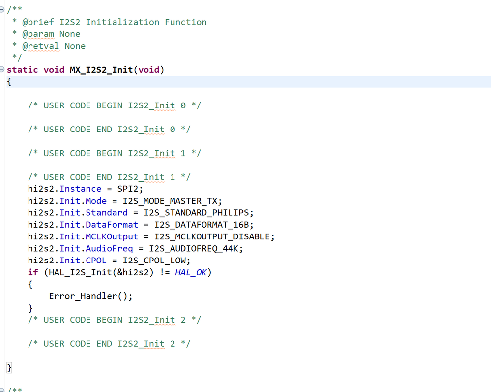

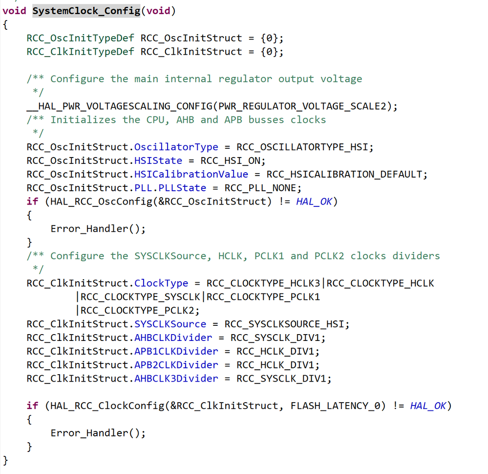

I used STM32WLE5JC control for playing the song via I2S. I have used SPI2 (alternat function of I2S) in the STM32WLE5JC. I can read the song in SD card and transmit the signal to the I2S in the I2S module (MAX98357A). The signal is transmitted to the I2S module and speaker ready to play. But I set the I2S exact hearable frequency(44.1khz) in the I2S initialization, that time noise is produced by the speaker. When I set the 8khz,11.025khz the song played slowly in the speaker. I am using MAX98357A mentioned frequency in the STM32WLE5JC, but no result.
I have attached the system clock & I2S configuration:

"Hearing the voices not clear" - what does that mean?
Do you hear the song, but noisy or distorted?
Are you sure the data from SD card has the correct format and endianness?
Maybe you're playing the LSB as MSB.
And check if you can setup all data transfers via DMA (I don't know that STM32):
SD -> DMA -> SRAM -> DMA -> I2S
or maybe even directly SD -> DMA -> I2S

@Community member
No, I can be able to hear some sound. But I couldn't identify whether the playing song is correct or not.
I have verified the same wav file formats song in ESP32 using I2S library.
How could I verify whether the LSB or MSB transmit first?
I didn't use DMA method for I2S data transmission. I am using interrupt method for I2S transmission.

you have to use circular DMA for player .

Practical i changed the PWR_REGULATOR_VOLTAGE_SCALE (AHB, APB1 frequency 16Mhz,64Mhz) song frequency in 8khz,11.025Khz,16khz,22.050khz, 32.khz,44.1khz and 48khz. I can be able to hear some sound. But I couldn't identify whether the playing song is correct or not.
I think i mistaked in the system and I2S clocks. So kindly share the reference for the Clock.

@LCE
I have used I2S in Interrupt method. I have used 16bit array (size - 4096) and stored the SD card read data. every I2S transmit the 4096 of data to send the I2S Module (MAX98357A).
Which method should I use for I2S data transfer? Interrupt or DMA.
