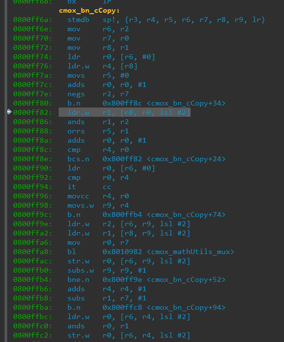

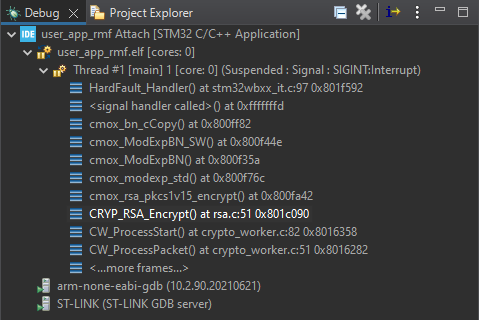

The stack trace indicates it's a problem from within the X_CUBE_CRYPTOLIB, when calling in "cmox_rsa_pkcs1v15_encrypt", the exception occurs in cmox_bn_cCopy. This method has been called thousands of times and never failed, so I don't know what's wrong.
The best I could do is inspect my code and make sure that all variables to "cmox_rsa_pkcs1v15_encrypt" are set properly, which they are. Since I don't have the symbols for the X_CUBE_CRYPTOLIB, I could only view the disassembly:
