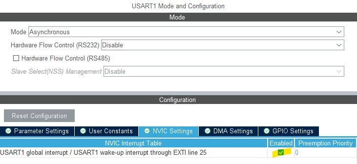

The code of HAL_UARTEx_ReceiveToIdle_DMA() will enable the IDLEIE bit, so enable the IDLE interrupt source inside the UART instance. Now in order to be genrated and processed the UART IRQ at NVIC side should also be enabled.
If you generate your code using STM32CubeMx tool, please make sure you do it in your UART configuration panel. (See below pic).
If not, IRQ could be enabled in MSP_Init functions (as HAL_UART_MspInit) by below code :
/* USART1 interrupt Init */
HAL_NVIC_SetPriority(USART1_IRQn, 0, 0);
HAL_NVIC_EnableIRQ(USART1_IRQn);Guenael

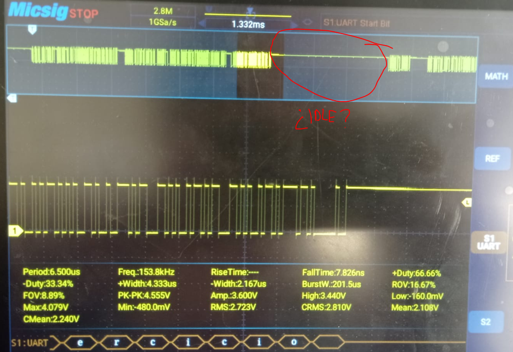

for 1 frame time, after last received byte.I dont think the STLINK's uart does that IDLE line thing when no activity happened.

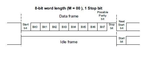

An Idle character is considered to be an entire frame of “1�?s (the number of “1�?s includes the number of stop bits). See below picture to be more clear.
After some activity on RX line, when an inactivity period lasting at least one character is detected (Idle state), the IDLE event is considered as occurring. If IDLEIE interrupt is enabled, then an interrupt is raised. This interrupt is used to inform application, in case HAL_UARTEx_ReceiveToIdle_DMA() has been called.
It corresponds to an inactivity period occuring after some reception.
Hope this helps.

Thanks @Guenael Cadier , so after sniffing the uart line i recognice IDLE times that should be detected by the ST32WB's uart
