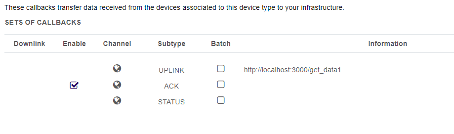

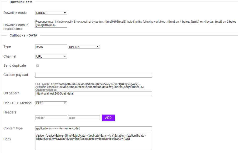

The sfx_error_t is composed of the following :When i send message to Sigfox Network Emulator. SNE can read message and show it into web. I already set callbacks function in SNE as bellow:
As I know, with config of callback. When SNE receive message from KIT, SNE will send downlink message that has content {time}0102{rssi} to KIT. But when I print dl_msg, just has 00 value like that:
