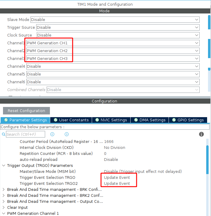

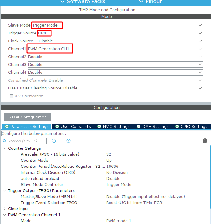

Hi @Sarra.S ,
Below are the timer configurations for slave trigger synchronization. I have also attached the IOC file for your review.
/* USER CODE BEGIN 2 */
HAL_TIM_Base_Start(&htim2);
HAL_TIM_Base_Start(&htim1);
HAL_TIM_PWM_Start(&htim2, TIM_CHANNEL_1);
HAL_TIM_PWM_Start(&htim1, TIM_CHANNEL_1);
HAL_TIM_PWM_Start(&htim1, TIM_CHANNEL_2);
HAL_TIM_PWM_Start(&htim1, TIM_CHANNEL_3);
/* USER CODE END 2 */Timer1 configuration
Timer 2 configuration
2024-07-02 8:40 AM
Trigger mode in Slave-mode controller does nothing else just sets TIMx_CR1.CEN.
In other words, the key is that slave must have TIMx_CR1.CEN=0 if you want to trigger it, otherwise the trigger is ignored.
I don't use Cube and don't know and don't want to know, if the way how you are clicking it in CubeMX and subsequently use in your program, fulfills this requirement or not. But if not, that's the reason why it does not work as you expect.

Sorry for the delayed answer, I cannot see any issue with your configuration, same clock for both timers, slave and trigger source are set correctly...

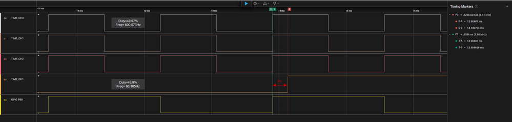

As discussed, I have the timers running at the frequencies you want, however the offset is still there!
I have tried to toggle a GPIO pin in an interrupt that occurs with the update event, to debug the phase shift, however the delay between the rising edge of the master and the TRGO output is (P1=600ns ) far less significant than the offset between master-slave (P0=226us)

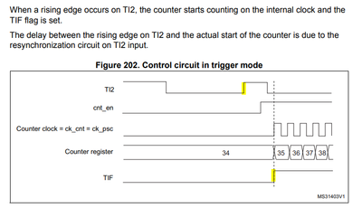

This delay is documented in the RM, in the slave mode: trigger mode paragraph:
However, I will be investigating the acceptable delay values...
